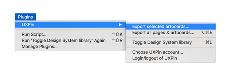

To import your designs, open the Plugins menu in Sketch, choose UXPin from the list and select one of the options. If you are not logged to the UXPin account at the moment, you’ll be prompted to provide your login credentials first.
You can export only selected artboards or a whole design at once.

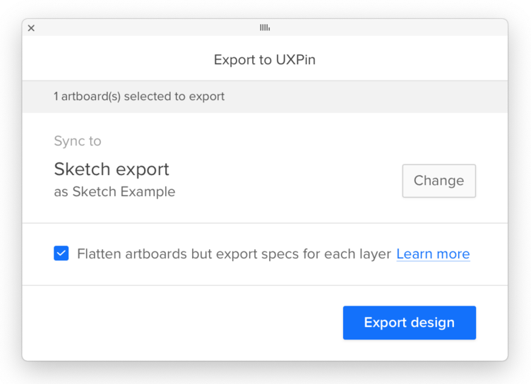

There are 2 types of export available. Choose Flatten artboards but export specs for each layer option if you want to prototype using hotspots and transitions or if you want to share the design with the team so they can inspect layers. This export type is faster than the regular option.
If you want to animate the layers separately, don’t select the checkbox. The layers structure will be preserved, but the export may take a bit longer to finish.
Once you are ready, click Export design. When the export is finished, click Open in UXPin to open the project in UXPin.
