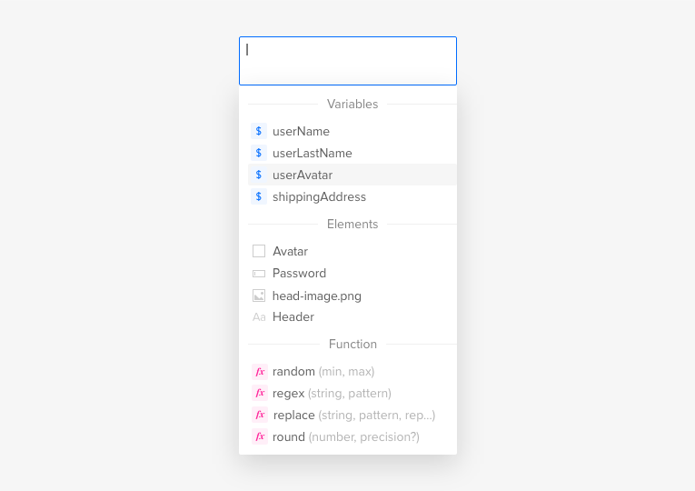

Choosing an expression as part of the interaction automatically displays the list with available variables, elements on canvas and all supported functions. To access the list while writing, type $ for variables, ‘ for elements and the first letters for functions.

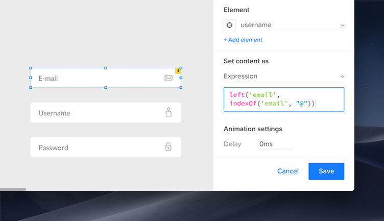

Consider creating a login from an email address provided by a user in the Input 1 element. To shorten the email and display only the characters before the @ sign, use these 2 functions:
indexOf(string, searchString)
Use it to determine the position of the @ character in the email.
left(string, number)
Use it to return the given number of the characters from the email, starting from the left side.
The expression will look like this:
left('Input 1', indexOf('Input 1', "@"))
Additionally, if you want the login to be displayed as lowercase only, you can add another function:
lowerCase(left('Input 1', indexOf('Input 1', "@")))

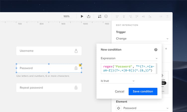

The regex function uses regular expressions (regexp) to validate if the text matches the given expression. Regexps basically define search patterns for strings — they can be anything from a simple character, a fixed string or a complex expression containing special characters describing the pattern. Read more about regular expressions here.
Use the regex function whenever you need to check if the text provided in the prototype by users matches the specific patterns. This way you can create validation forms that check whether all the password requirements have been met. For example, a password has a specified minimum amount of characters, or the characters used are alphanumeric. Similarly, you will be able to verify if the provided text is a correct email address or URL.
The regex function has the following syntax: regex(regexp, string). It returns the true or false boolean value depending on the result of the check.
When using regex in the expressions, it’s always worth validating if the regular expression is written properly. You can do this by using one of the online regexp validators, such as regex101.com.
