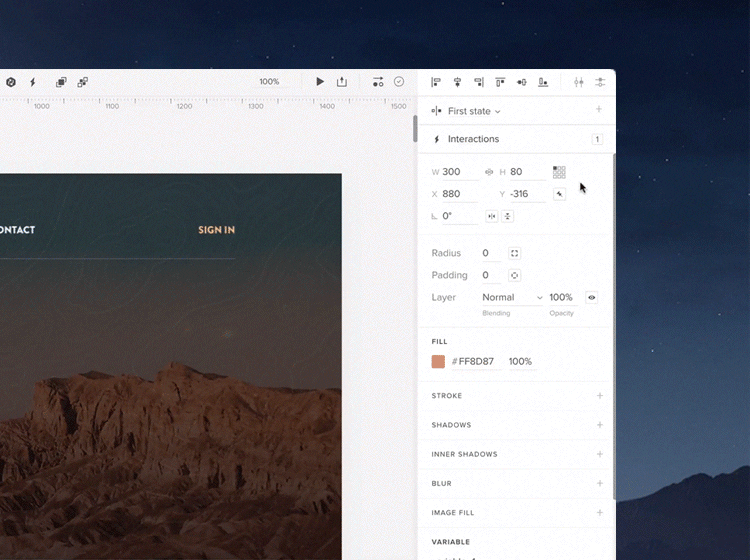

In UXPin, you can add interactions to Elements and to the Canvas. You can add an Interaction:
  • From the Topbar with the Interactions icon.
  • From the Properties panel with the + icon.
Existing interactions are marked with numbers. Invalid interactions are marked with a red highlight.

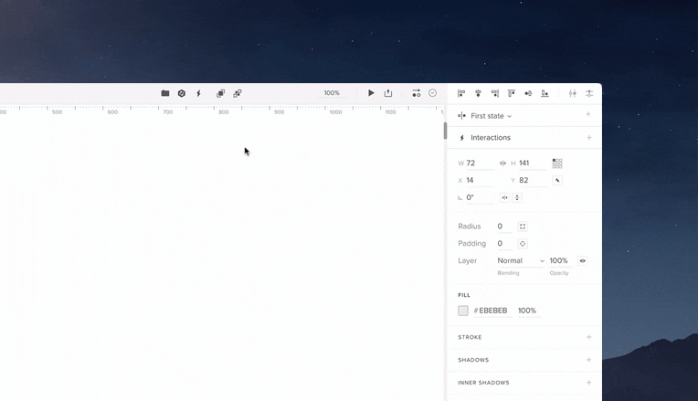

Copying Interactions
You can copy any existing interactions and paste them to one or many elements at the same time, even between Pages. To copy an interaction, right-click on the element with an existing interaction and select Copy Interaction. You can copy All Interactions or copy selected ones. To paste the copied Interactions onto any other element or a group of elements, right-click on it to open the context menu and choose Paste and then Paste Interactions.
Duplicating Interactions
Duplicating Interactions is possible from the Interactions panel to the right side. Just hover over an existing Interaction and click the Duplicate icon.
Deleting Interactions
To delete an Interaction, go to the Interactions panel and click the "X" icon.

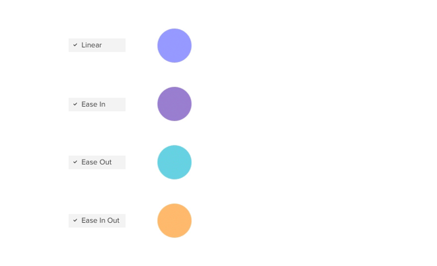

Easing lets you control how the interaction is performed over time. Choose one of the following effects:
  • Linear – reflects constant speed and steady movement from point A to B;
  • Ease In – starts slow and accelerates at the end;
  • Ease Out – starts quickly and slows down at the end;
  • Ease In Out – starts slow, gains speed and then slows down at the end.

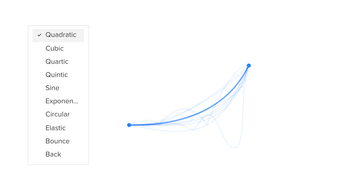

For each easing you can also define its curve to simulate the natural movement, similar to real-life objects.You can choose from the following curve types:
Tip
You can define the Amplitude and Springness for the Elastic curve.

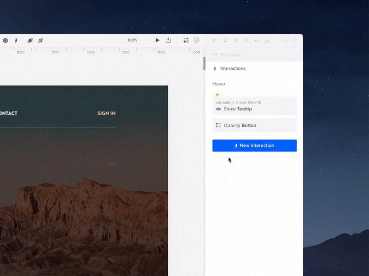

Conditional Interactions
Conditional interactions allow creating the flows of interactions to resemble the real applications closely.
They are the system of rules to determine whether a given interaction should be performed or not. All conditions have the “if-then” structure – if the conditions are met, then the action will be executed.
In UXPin the conditions are added to specific interactions. Each interaction can have multiple conditions. In such cases, you’ll be able to specify if the interaction should be triggered once any of the conditions is met or only when all of them are fulfilled. Read this how-to tutorial to learn how to validate email and password using conditions.
To add the condition, while setting the interaction click the plus icon in the Conditions section. Next, you’ll need to specify the condition settings:
  • an item to be compared – value of variable, content of the element, value or an expression;
  • the condition – the type of comparison;
  • an item to compare with – value of another variable, content of another element, another value or expression.
If you are adding an interaction to a state of an element, you will also be able to use the “Active state” name as an item of comparison.
