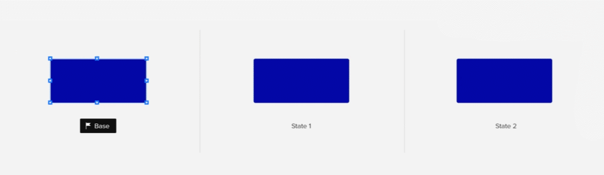

Base State
Each element with states has a base state. It’s a primary state of an element — a foundation on top of which other states are built. The base state is marked with the flag icon, so you can easily see it in the States menu.
Whenever you update the base state, changes will automatically appear in all other states.
Editing the base state will affect all states, but you can also edit these states separately. In other words, you can edit them all at the same time when changing the base state, or one by one. However, properties already edited in other states before won’t be updated. You can always reset the edited properties or the whole state whenever you want.

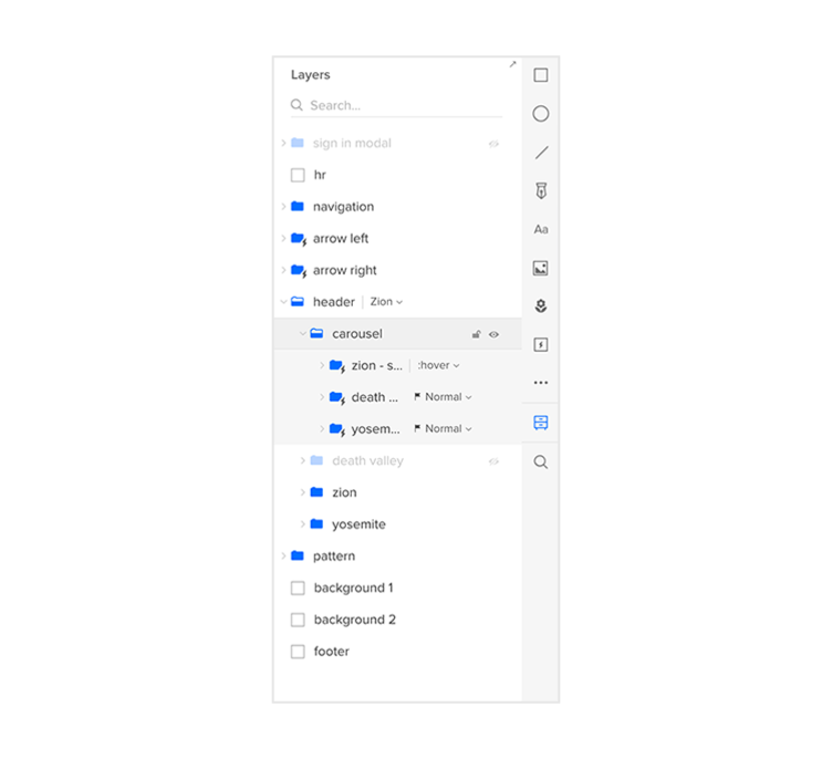

If you add an extra element to the base state, it’ll be automatically included in other states as well. However, if the element is added to any other state, it will be visible for this state only — it will be included as a hidden layer for other states and you’ll be able to make it visible by clicking the eye icon in the Layers panel.
Also, since you’re not able to delete elements from the selected states only, you can simply hide them in the Layers panel.

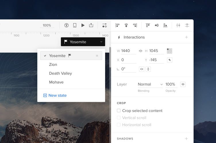

To add a state to the element, select it on the canvas and click the Add new state icon in the top bar Ctrl "Shift" "S" . You can access it also in the context menu. Next, set the name of the state and confirm with Enter.
Managing States
You can manage states from the States menu. Once you open the menu, you can do the following actions:
  • Switch between the states — click on a state from the list to set it as an active state on the canvas
  • Add state — click +New state
  • Rename — double-click the state’s name
  • Reorder — grab the first icon next to the state’s name and drag it to the desired place
  • Delete — click on the red x icon
  • Reset all changes to base state — click the arrow icon to reset properties to the base state

You can create nested structures with states. Consider building a form component which consists of an input with 2 states (empty and with added email) and a button with an active and inactive state.
By setting the active states in the Layers panel, you can determine which state of the nested elements should be displayed once the state of the parent element is changed. This way, you’ll be able to build a relationship between the state of an input and state of a button to display a proper combination.
