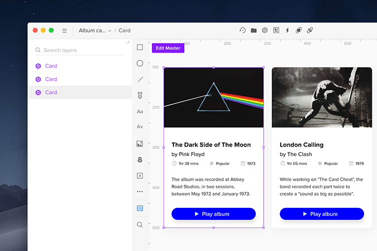

Editing the Master Component
You can edit Components in two ways –  the Master with all its Instances, or edit each Instance independently.
To edit a Component’s Master, select an Instance and click the Edit Master button in the top left corner of your workbench, click Edit Master in the Properties panel, or open the context menu and go to Component > Edit Master – this will open a separate view for the master component. Any changes you make there will immediately propagate to all Component Instances.
You can also change the Master Component's name in the left corner of the Top bar. When done, click Back. The Master Component’s name appears in the Properties panel in the Instance section, not in the Layers panel.

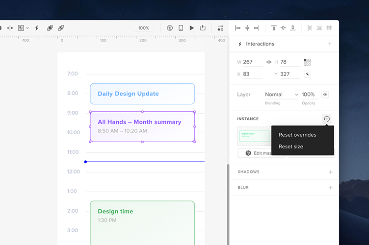

Resetting Overrides
You can reset overrides for the Instance or for a selected element inside an Instance:
  1. For a selected Instance you can reset overrides in the Instance section in the Properties panel and in the Top bar by clicking Reset or in the context menu. You can either reset all overrides or its size.
  2. For a selected element you choose which specific property you want to reset. To do that, click on the Reset icon at the top of the Properties panel and click on the properties you want to reset.

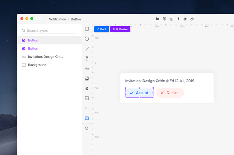

Nested Components
Nested Components are the components you create inside another Component – any changes in a nested component will propagate to its Instances. Apart from that, you can also create nested components by selecting numerous Instances on the canvas and turning them into a Component. Nested Components, just like regular Components, can also be overridden. There’s no limit to how deep you can nest Components, but remember that a Master Component can’t contain its own Instance.
