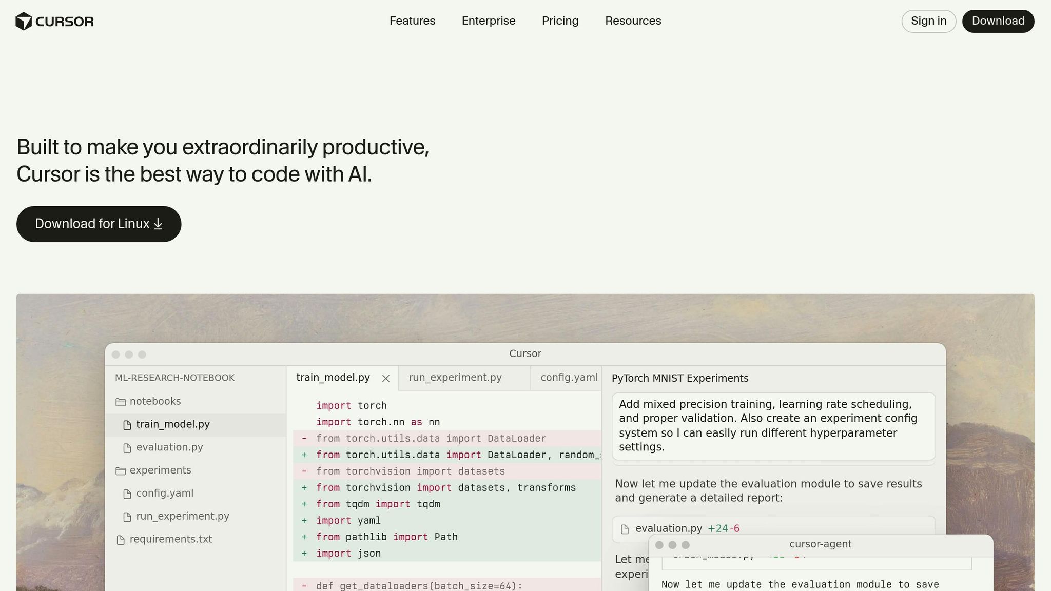

    2. Using Cursor for AI-Integrated Development
    Cursor
    Cursor acts as a central hub for writing and managing AI-generated code. Its Agent Mode autonomously executes task lists, significantly reducing manual coding effort. Kevin shared his strategy in pairing Cursor with a pre-configured "agent folder" in his repositories. This folder serves as a contextual workspace for the AI, containing instructions, examples, and scratchpad files that help the agent stay on track.
    • Why It Works: By isolating AI-specific files from the main codebase, developers prevent the agent from unintentionally modifying critical files while still giving it the flexibility to explore and iterate.
    Pro Tip: Add specific rules for the agent to follow. For example:
    "Focus only on React components in the ‘src/components’ folder. Use Storybook for visual testing and ensure all states are documented."

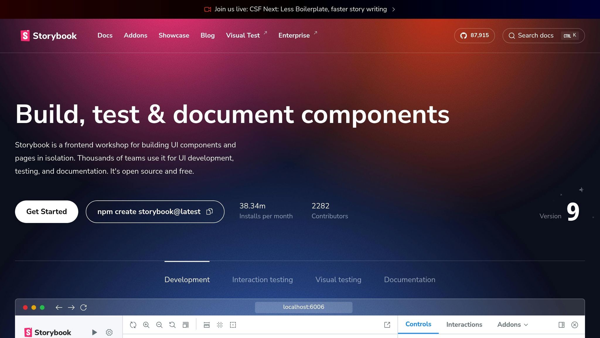

    3. Storybook as an AI Partner
    Storybook
    Storybook plays an invaluable role in visually verifying AI-generated components. Since front-end development is intermediated by the browser, Storybook enables developers to:
    • Express every key state of their components.
    • Visually confirm that the AI-generated code renders as intended.
    • Generate edge cases automatically, including accessibility and responsive states.
    Kevin demonstrated how Storybook becomes especially useful when paired with Cursor. Storybook handles the visual verification of components, while Cursor handles code generation. For example, AI-generated Storybook stories included:
    • Default, loading, and disabled button states.
    • Edge cases like long labels and high-contrast modes for accessibility.
