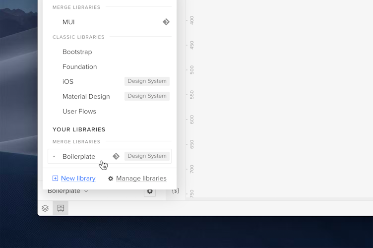

8. Push your library to UXPin. First create a library in the UXPin Editor: select “Import React or Web Components from Git repo” and copy the authentication token. Don’t share it and don’t commit it to Git.
Then run:
npx uxpin-merge push --token <your-library-token>

Integrate a public Storybook
1. Open a new or existing prototype from the UXPin Dashboard.
2. Select the ‘Design System Libraries’ tab at the bottom left, then click ‘+ New Library’.
3. Select ‘Import Components from Storybook’, enter the URL of your Storybook and save the library.
