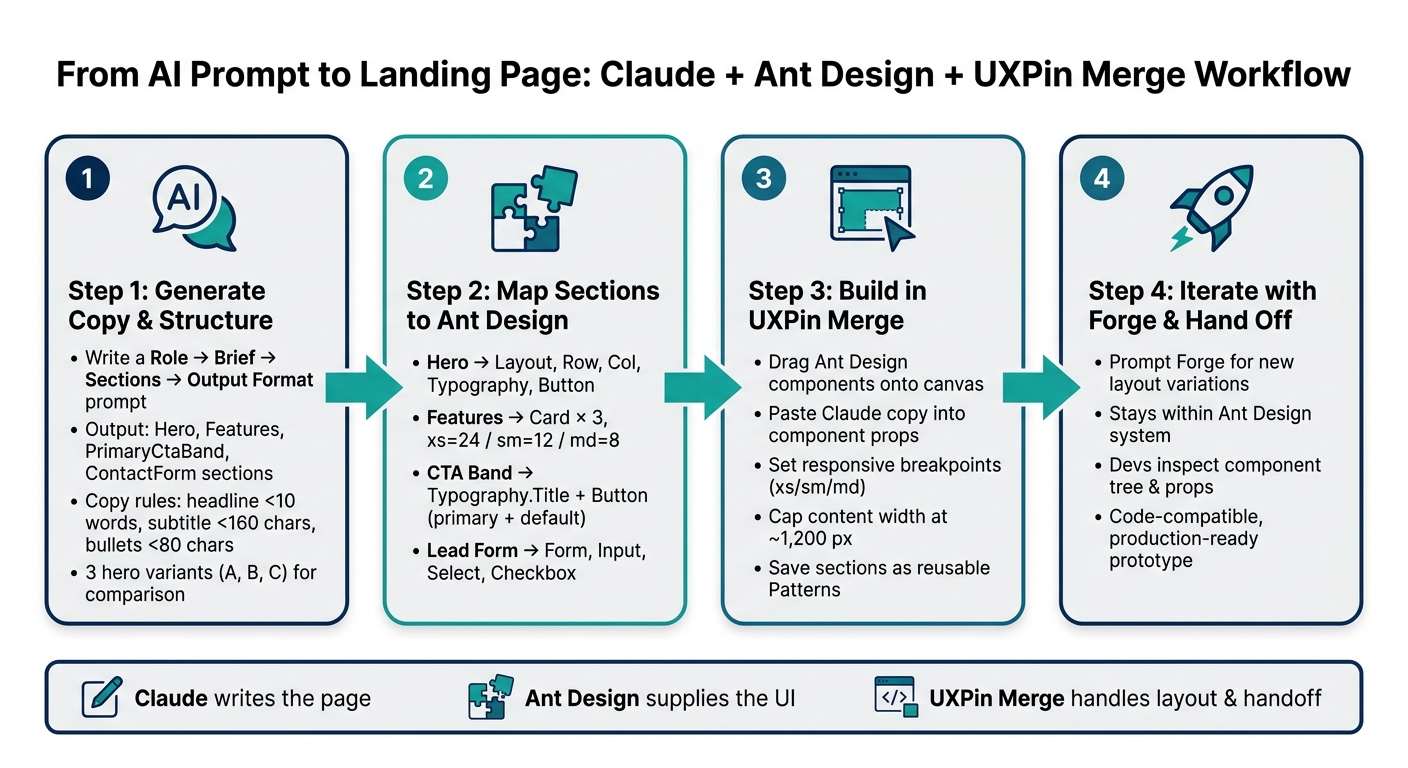

If you want a short version, it’s this:
- Start with a labeled prompt in Claude
- Map each section to Ant Design components
- Build the page in UXPin Merge
- Use Forge for more layout versions
- Hand off a prototype tied to the same component system devs inspect
In other words: this article is a step-by-step way to build a landing page that stays close to production from the first prompt.
From AI Prompt to Landing Page: Claude + Ant Design + UXPin Merge Workflow
Step 1: Generate landing page structure and copy with Claude Haiku 4.5
Claude Haiku 4.5 does best when you give it a short, labeled brief that leads to UI-ready output. Think short text fields that can drop straight into Ant Design props. Then, in Step 2, you’ll map each section to Ant Design components.
Write a prompt for sections, audience, and conversion goal
Start by setting three inputs: product, audience, and one conversion goal. In this walkthrough, the product is a B2B marketing analytics platform that helps U.S. marketing teams track real-time campaign ROI across channels. The audience is marketing managers and directors at midmarket tech companies with 50–500 employees. The conversion goal is a single action: Book a live demo.
Put those inputs into a labeled design brief at the top of your prompt. Then tell Claude which sections to generate and the order to use. The prompt pattern that tends to work best is Role → Brief → Sections → Output Format:
Act as a UX copy assistant helping design a B2B SaaS landing page implemented with Ant Design components inside UXPin Merge. Product: a marketing analytics platform for U.S. marketing teams. Audience: U.S.-based marketing managers at midmarket tech companies (50–500 employees). Primary CTA: Book a live demo. Format prices as $249 per month. Use commas for thousands and periods for decimals (e.g., 1,200 campaigns, 3.5x ROI). Output a structured JSON-style output with these sections: Hero, Features, PrimaryCtaBand, ContactForm. For each section, include only short, UI-ready text fields – title, subtitle, bullets, buttonLabel, field labels and types. No long paragraphs. Avoid any code syntax that might break JSON.

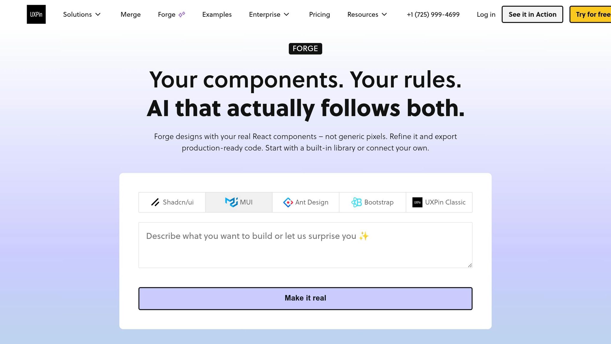

Step 4: Speed up iteration with UXPin Forge and prepare for handoff
After you build the first Ant Design layout in UXPin Merge, UXPin Forge helps you move faster without rebuilding what’s already done. Forge is UXPin’s built-in AI assistant. It creates and edits layouts using only approved design system components, so the versions it generates stay code-compatible and on-system.
Use Forge to build Ant Design layouts from prompts
Once the layout is in place and the copy is ready, use Forge to spin up new versions without leaving the same Ant Design system. From this point on, Forge handles the visual layout work. Prompt Forge directly inside UXPin with the structured section outline Claude produced earlier.
A good Forge prompt is specific. For example:
"Using our Ant Design library, build a responsive landing page with a left-aligned hero, a three-column feature grid, a CTA band, and a right-sided signup form capturing name, email, company size, and job title. Stack to a single column below 768 px."
That kind of prompt gives Forge a clear lane to follow, which makes the output much easier to use.
After Forge generates the first layout, drop Claude’s copy into the matching props – Typography.Title for headlines, Typography.Text for supporting copy, and Button labels for CTAs. Then adjust breakpoints and column spans on the canvas. Developers can inspect the component tree and props directly.
At this stage, the goal is simple: move through iterations faster while keeping the prototype lined up with production components. That gives you a shorter path from approved copy to a developer-ready landing page.
