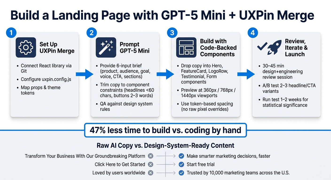

    In short, I’d describe the process like this:
    1. Set up Merge with your React library.
    2. Prompt GPT-5 Mini with your product brief and page goals.
    3. Trim the copy to fit component limits like character count, states, and labels.
    4. Assemble the page with code-backed hero, cards, logos, testimonials, and form components.
    5. Review and test headline and CTA variants in the same structure.
    If you want a landing page that is faster to approve, easier to build, and closer to production from the start, this workflow is the point of the article.
    How to Build a Landing Page with GPT-5 Mini & UXPin Merge: 4-Step Workflow
