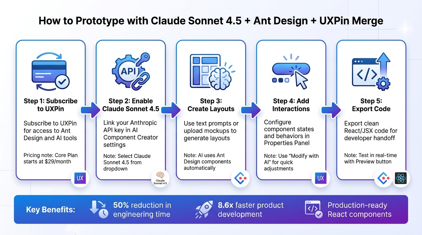

Steps to Get Started:
  1. Subscribe to UXPin for access to Ant Design and AI tools.
  2. Enable Claude Sonnet 4.5 by linking your API key.
  3. Use text prompts to create layouts and refine them with Ant Design components.
  4. Add interactions and test your prototype instantly.
  5. Export clean React code for seamless developer handoff.
Why It Works: By using actual code components instead of static mockups, teams reduce engineering time by up to 50% and speed up product development by over 8x. This workflow ensures consistency, minimizes handoff issues, and keeps designs aligned with development standards.
Pro Tip: Write clear, specific prompts for better AI results, and use Ant Design to maintain design consistency across projects.
5-Step Process to Prototype with Claude Sonnet 4.5, Ant Design, and UXPin Merge
