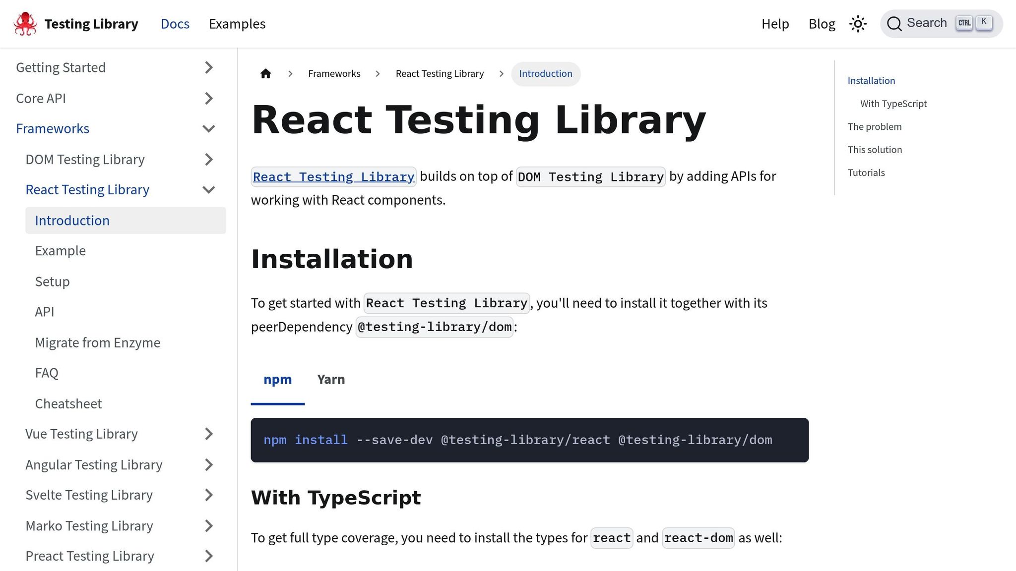

Installation and Configuration
To get started, install Jest and React Testing Library by running the following command in your project directory:
npm install --save-dev jest @testing-library/react @testing-library/jest-dom
If your project uses Create React App, Jest is already configured, so you’ll only need to add React Testing Library. For custom setups, you may need to configure Jest manually. Create a jest.config.js file in the root of your project to define the test environment, set coverage options, and handle module resolution.
