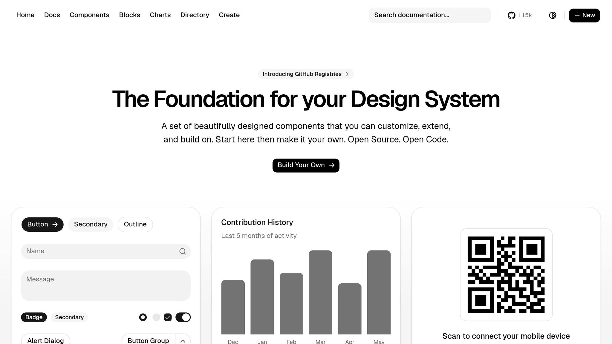

What is shadcn/ui and why does it work well with Merge?
shadcn/ui is a collection of open-source React components built using Radix UI primitives and styled with Tailwind CSS. What makes shadcn/ui stand out is its approach to code ownership. Instead of relying on third-party dependencies, you copy the components directly into your project, giving you full control to modify and adapt them as needed.
This level of ownership is a perfect match for UXPin Merge. It allows designers to work with real, functional components like Buttons, Dialogs, and Forms – the same ones developers use in production. This alignment bridges the gap between design and development, ensuring consistency throughout the process. By integrating shadcn/ui into your UXPin Merge setup, you can make the most of this synergy.

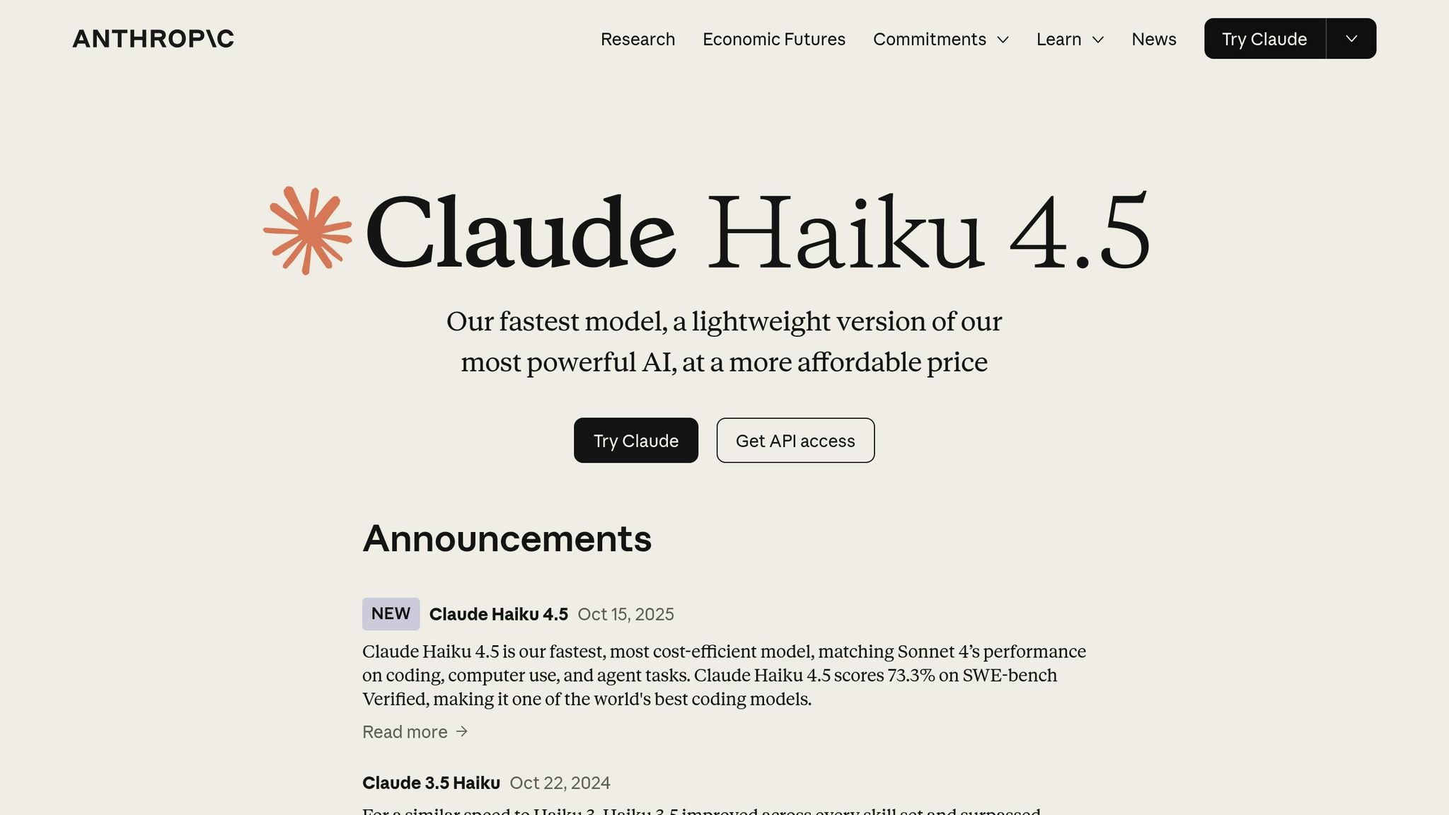

How Claude Haiku 4.5 improves design workflows
By integrating shadcn/ui through Merge, you can leverage UXPin Forge to create complete layouts quickly. Forge, UXPin’s built-in AI assistant, works seamlessly with Claude Haiku 4.5, enabling you to generate layouts directly on the canvas using your actual shadcn/ui components.
With Claude Haiku 4.5, you can produce layouts almost instantly, allowing you to explore multiple design options within a single session. Just describe your requirements, and Forge will place the right components with accurate props. It also excels at maintaining context throughout your session, so follow-up prompts like "make the CTA primary and disable it until the form is valid" are applied directly to the existing layout – no need to start over.
According to UXPin, teams using Merge report up to 10× faster prototyping compared to building UI from scratch. Forge takes this efficiency even further by eliminating the manual assembly step, creating a smooth bridge between design and development.
