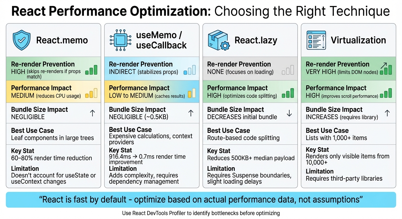

React Performance Optimization Techniques Comparison Chart
This section takes a closer look at the pros and cons of various React optimization techniques. By understanding these trade-offs, you can make informed decisions about which approach best suits your app’s performance needs. The analysis covers performance improvements, resource costs, and ideal scenarios for each method.
React.memo is a great tool for avoiding unnecessary re-renders in functional components. It works by comparing props and skips rendering when they haven’t changed. However, it doesn’t account for state changes triggered by hooks like useState or useContext. On the plus side, it adds almost no extra weight to your bundle and fits well with modern React practices.
useMemo and useCallback shine when it comes to stabilizing references in computationally heavy operations. For instance, tests showed useMemo could cut render times from 916.4ms to just 0.7ms. That said, these hooks can add complexity and require careful dependency management. As Sarvesh SP points out:
"React is already fast at DOM updates through its diffing algorithm. The expensive part is the JavaScript execution during re-renders".
While these hooks help reduce JavaScript overhead, overusing them can lead to unnecessary complexity.
React.lazy focuses on shrinking your initial bundle size, which can speed up startup times. However, it requires wrapping components in Suspense boundaries, which can introduce slight delays when loading components. Similarly, virtualization boosts performance for large lists by rendering only the visible items at any given time. The downside is that it typically requires third-party libraries, which add to your bundle size.
| Technique | Prevention | Impact | Bundle Size Impact | Best Use Case |
| React.memo | High (skips re-renders if props match) | Medium (reduces CPU usage) | Negligible | Leaf components in large trees |
| useMemo / useCallback | Indirect (stabilizes props) | Low to Medium (caches results) | Negligible | Expensive calculations, context providers |
| React.lazy | None (focuses on loading) | High (optimizes code splitting) | Decreases initial bundle | Route-based code splitting |
| Virtualization | Very High (limits DOM nodes) | High (improves scroll performance) | Increases (requires library) | Lists with 1,000+ items |
