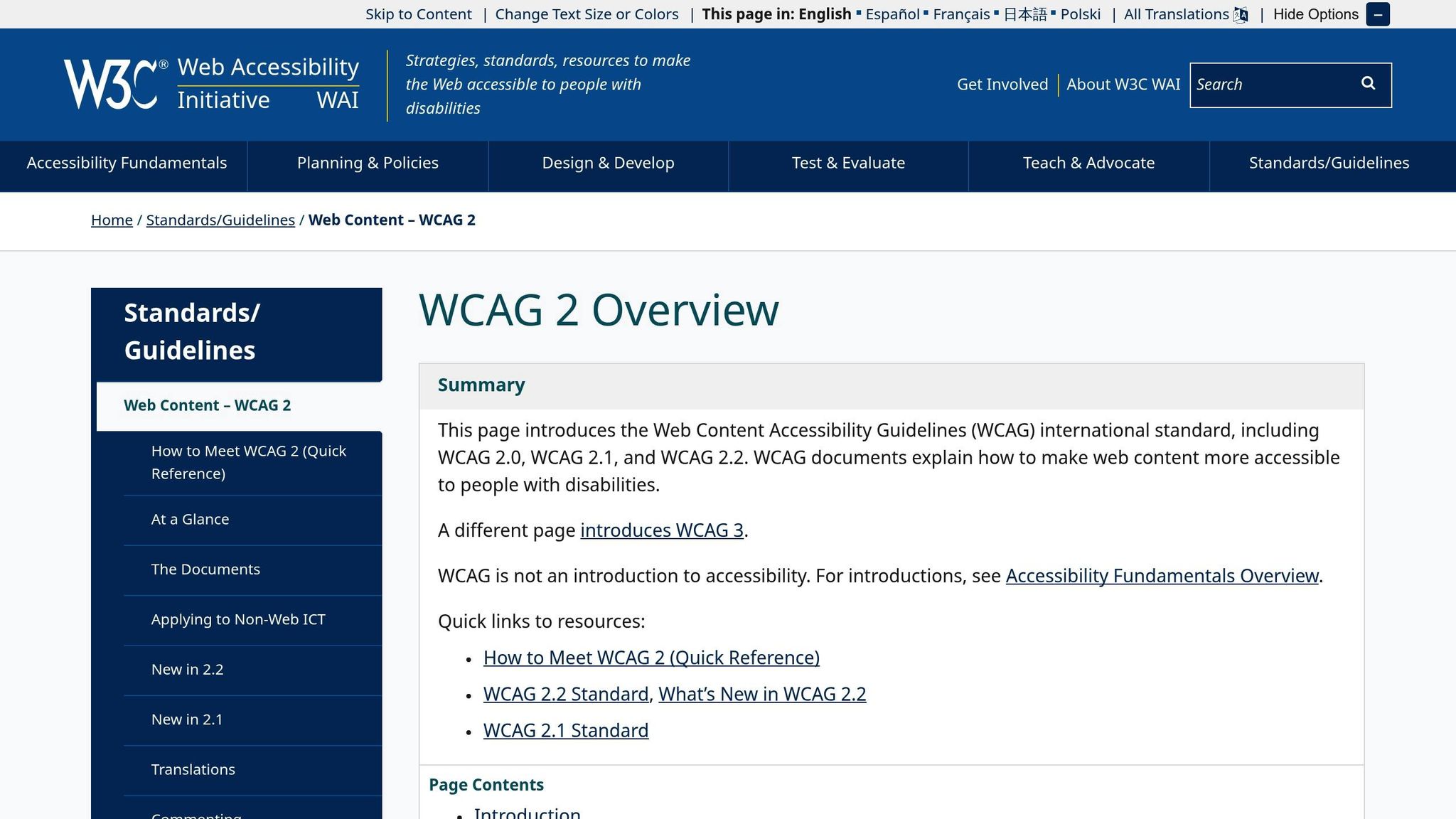

    How to implement WCAG 2.1 Success Criterion 3.3.1 Error Identification in code with examples
    WCAG

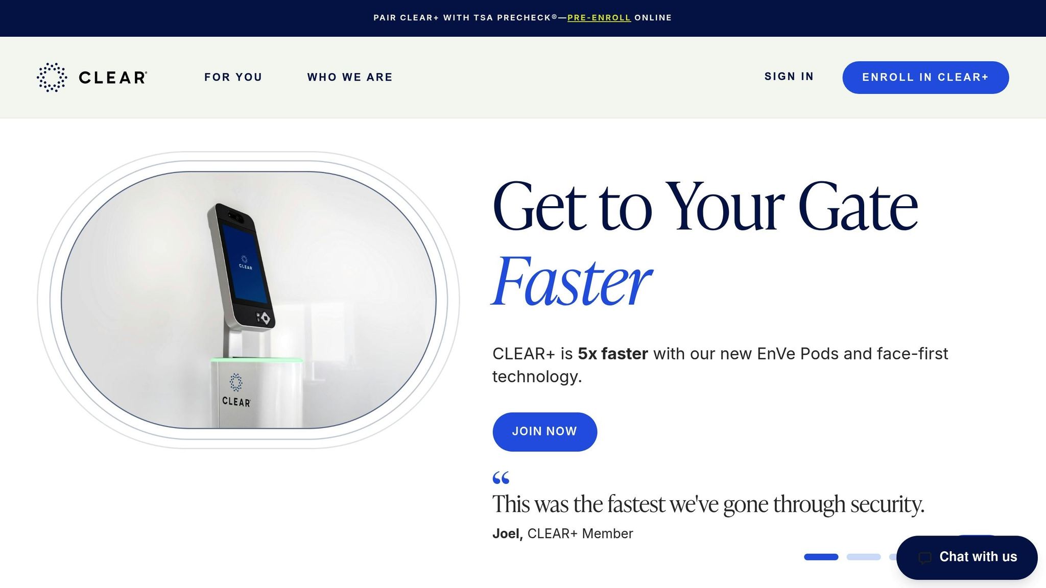

    Clear
    Error messages should be easy to spot and placed near the field causing the issue. Visual design is critical here. According to the Web Content Accessibility Guidelines (WCAG 2.1), text should have a contrast ratio of at least 4.5:1 for regular text and 3:1 for larger text. But relying on color alone can exclude users with color vision deficiencies. Instead, combine multiple visual elements like bold text, high-contrast colors, and icons.
    For example, CLEAR enhances accessibility by showing real-time indicators near password fields, outlining specific requirements as users type. This approach helps users avoid errors before they happen.
